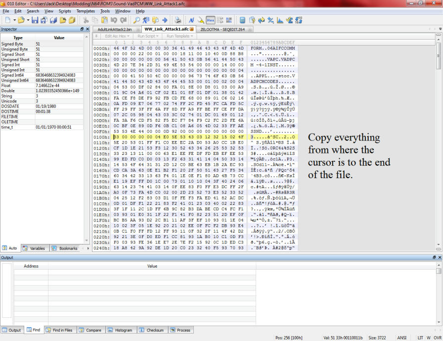

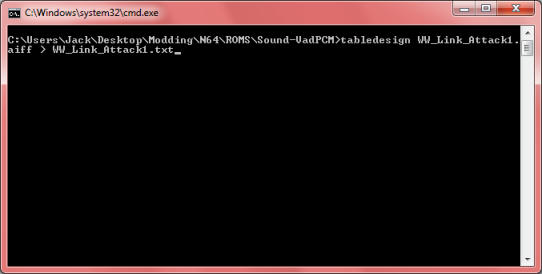

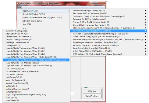

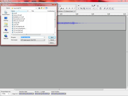

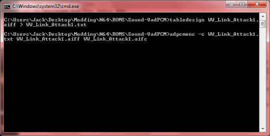

Jack Walker Posted May 9, 2013 Share Posted May 9, 2013 This tutorial is designed for the Debug ROM in particular. However, it can be used with other versions of Zelda as well as most N64 games. Things you need:N64 Sound ToolsA hex editorTableDesign and AdpcmencAudacity 1. Extract Adpcmenc and TableDesign to somewhere. It is recommended that you keep these two files together, along with the sound effect you wish to convert. 2. Open up N64 Sound Tools and select File->Open Known Game->Ken Griffy's...-> Legend of Zelda Ocarina of Time Debug ROM. Navigate to your ROM file and open it. 3. Find the sound effect you want to replace by selecting an "Instrument" and clicking play. 4. Once you have found the desired sound effect to replace, click on the button labeled "16-bit Raw" in the bottom right of the window and save the file to somewhere. We will be using this later. 5. Your sound effect needs to be converted into the aiff format. Open up audacity and open the sound effect. Go to File->Export and save your file as an aiff. 6. We will need to create a "codebook" to convert our sound. Open up command prompt and navigate to the directory with the conversion tools and the sound effect. Run the program tabledesign with the following syntax: "tabledesign mysoundeffect.aiff > codebookname.txt". 7. Now you can convert your sound effect to a format the N64 understands with the program adpcmenc. Using the command prompt, run the program with the following syntax: "adpcmenc -c codebookname.txt mysoundeffect.aiff mynewsoundeffect.aifc". 8. Now you need to find the location of the sound effect inside OOT's ROM. Open up the sound effect we extracted earlier in a hex editor and the ROM and search for the first 5 bytes or so of the sound effect in the ROM. If you find multiple results, add more bytes from the sound effect to the search. 9. Finally we need to copy the sound data to the ROM. Find the string "SSND" inside the sound effect and copy everything one line below it. Then, paste the data into the ROM from where the sound effect is located. 10. If all goes well, the sound effect should be playable in the game. One important thing to note is that if the sound effect is smaller than the one you are replacing, then part of the original sound effect may play in addition to the one you replaced. One way to fix this is to write zeros over the leftover data in the ROM. Another problem is that if the sound effect is bigger than the original, it will overwrite other sound effects and may not play properly. The solution to this is to change the pointer that dictates where the sound is located in the ROM. I will update my tutorial with information on how to do this. Below is a video demonstrating custom sound effects. If you have any ideas for improving this tutorial, feedback is appreciated. 11 Link to comment Share on other sites More sharing options...
